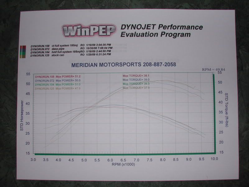

OK I know Driver and I made ya wait, so here you go HMF, DASA slip on, CT, and stock system

If I'm reading this right looks like HMF full system is better overall?
It did good for sure but I think the ct made more bottom end and same topend. I think the dasa slip on did very well to. Fell off up top but made the most bottom and mid.
1,365 Posts
Y it slloks like HMF ftw. 1ft lb more torque and .2 les HP. Id rather have that torque myself ;)
Me too on the torque! Driver if you had to pick a pipe after all the testing wich one would you go with for woods racing?
Its hard to say. IF I had a 525 Id have a dasa slip on. The bottom and mid is just killer on it and the top holds strong. Plus it looks and sounds killer.
I just dont see anything out there really bettering stock that is quiet. I think the hmf slip on would even be good. They have a nice quiet core. Ill be testing the hmf on my bike with quiet core. If it makes more than stock, than that will be a good option. Should be the same on the xc.
Thanks Driver
