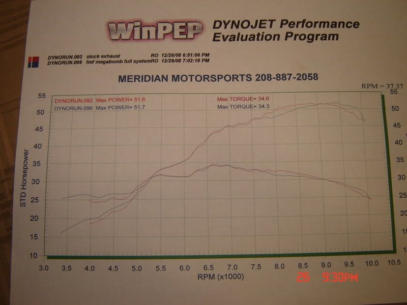

Sorry to bust your bubbles but this wasnt on an sx. It was on an 08 ltr. Mods were je 13.5 piston, hotcam intake cam, mild ported head, fuel intake, and yosh pim. Stock pipe vs. fmf ti megabomb full system. LOL This is funny. Can you say waste of $700 dollars for Ltr owners anyways. I just dont see it being any better on the ktm. Sorry boys. Soon as someone sends me theirs Ill throw those numbers up to. I can test anyones fmf on either the sx or xc.

Another guy on the ds450 forums posted similar results. He said the full system lost about 3/4whp over stock pipe with cork out. He then took the megabomb head pipe off and put the stocker back on and gained 2whp over stock can. So it was just a slip on. Though the only thing I can say about this is that the ds450 has a very bad stock can and should be easy to slip something on and make more power. Obviously the megabomb is a power robber on the ds450 and the ltr450. I dont see it being different on other machines.

The pipes are given to them as sponsorship. Thats why they run them. They dont have a choice. Ktm and fmf are paired up. Thats my opinion on the deal. Fmf has proven to be a gimmic!!!!

So sad, I have the full system and now I feel like I got raped on this hole system. So anybody wanna buy a full fmf system.. Big B

Big B- Dont get upset, send your pipe to Driver to have him test it FIRST, maybe its better matched on the KTM!

Send it to me to test. You never know and better to know than hope!! I can test it pretty quick and send it back. Rancheros bike is literally 3min from the dyno. We can use his bike or my sx depending on what you have it for.
